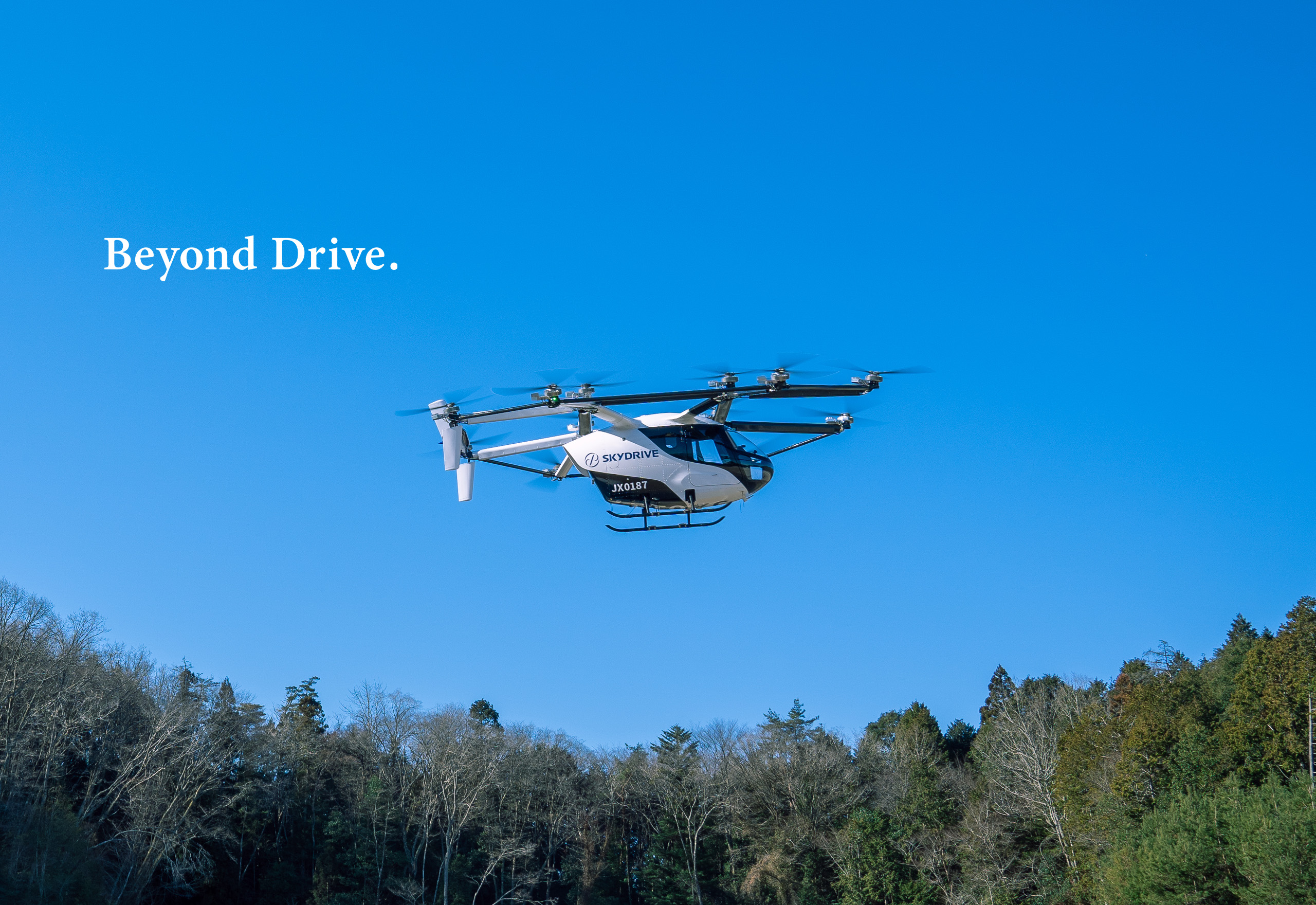

Just seen this
Need better batteries, but they look pretty cool. How would the auto rotations go? I guess with 8 motors there is some redundancy. Or will they just use a deployable parachute like some of the composite planes.
FAA approved passenger drone parts are going to be expensive!
One thing to keep in mind is fewer longer blades are a lot more efficient than many shorter blades, so advantage helicopters over multi-rotors for efficiency and flight duration. Personally, I think the serious eVTOL designs will transition to forward fixed-wing flight once they are airborne. We are on the cusp of something, but I'm not sure yet exactly what it will look like ... probably mostly for high rollers to hop roof tops in the big city.
