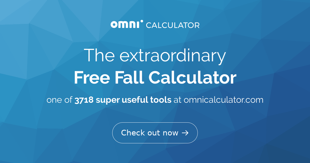

I appreciate all the responses. Now that I have a good idea that a drone will fall like a rock, I was able to calculate the "drift." I've been able to determine that from 400 feet it will impact the ground in 5 seconds. If hovering in a 20 mph wind, in 5 seconds it will drift 147 feet.

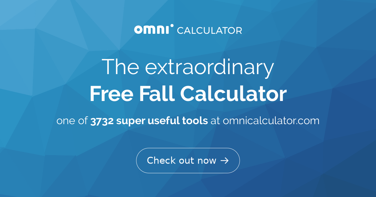

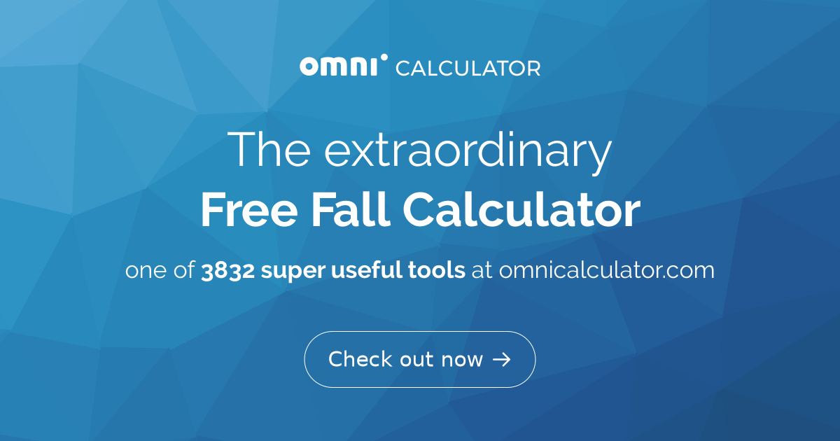

Although I had a physics class in high school, I confess I didn't plug the numbers into a formula for determining acceleration, etc. of a falling body. Instead I use this shortcut that I found:
Using that calculator you can plug in any height and determine how long it will take a body to fall as well as the velocity at impact. Using 400 feet the calculator comes up with 5 seconds until impact (which was confirmed by using some google searches as well). For the distance I started with a 20 mph wind (thinking that would be about the maximum wind speed I'd be flying in) and did the math from there as to how far an object wold travel at 20 mph in 5 seconds, which is 147 feet, presuming I didn't make any math errors. In a 10 mph wind it would be about 74 feet.
Your freefall calculator isn't worth much unless you are interested in objects falling in a vacuum.
In the real world air resistance is a real factor.
DJI drones up to the size of a Phantom reach a terminal velocity of 12-14 metres/sec fairly quickly.
I haven't seen data for an Inspire or Matrice.
If your were looking at a hypothetical Phantom or Mavic falling from that height, it would take about 10 seconds.
