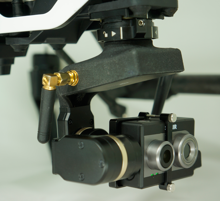

Do you know if there is a FLIR DUO option that works on the DJI Inspire 1 V2 platform?
Reactions: Outta Control
@Outta Control Excellent information.
Hi Big,
Unless you mean full integration. I do not know of one but with a little but of tinkering sure.
The great part is the Duo is shaped exactly like a GoPro cam which has lots of accessories.
Here is an acceptable set up for cheap.
Update: I correct myself.
FLIR Duo gimbal for Inspire 1 (Full HD downlink)
@Outta Control which of the DUO is what you'd call "minimal" in being able to provide SAR and Fire Dept auxiliary support? We don't have a huge budget but spending ANY money on something that doesn't do the job is worse than spending too much on something that does.
@BigAl07 if the main driver for this camera is for SAR and such I would recommend looking at a FLIR VUE part# 436-0004-00 they are currently on sale.
This unit will not record thermal images just a pass through. If you wasn’t to record then the price jumps up a lot.
Thank you @Outta Control . I don't think the VUE will fit into the Inspire1 V2 gimbal we discussed earlier:
So if I go with the above gimbal which means I need to stay with the DUO form factor, the Radiometric option adds roughly $300 to the base price. How "wanted/needed" is Radiometric for SAR and Fire Dept support type scenarios?
...How "wanted/needed" is Radiometric for SAR and Fire Dept support type scenarios?
